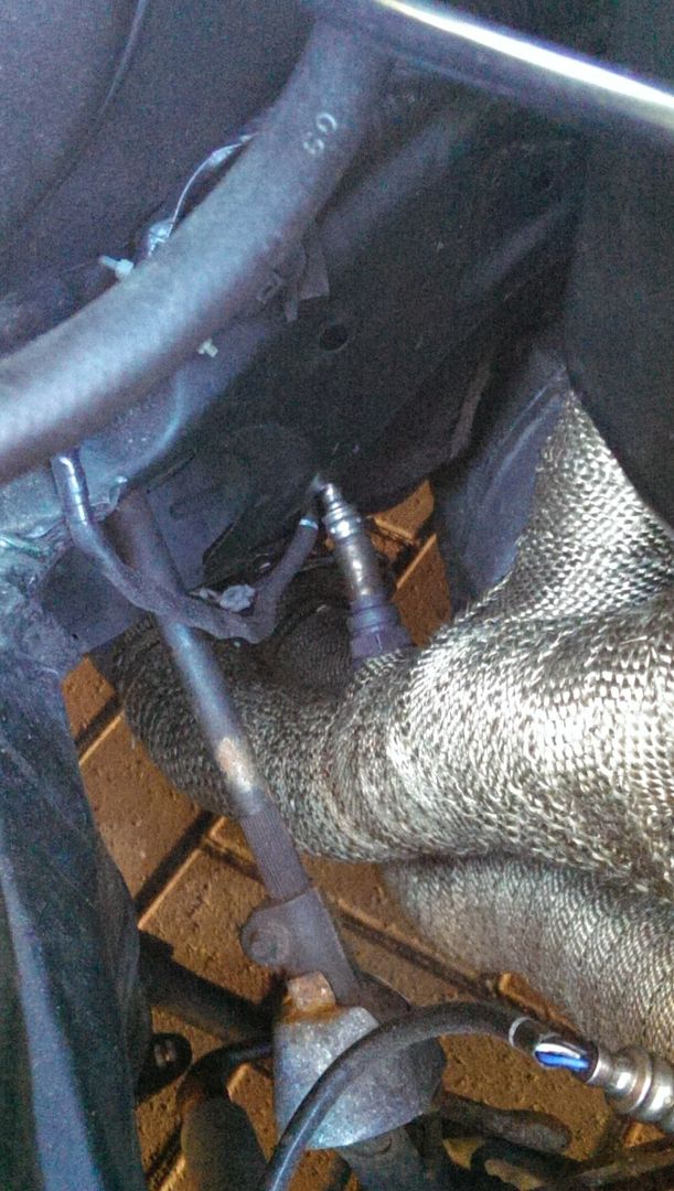

James S Just picked up a couple of new bits. Stainless manifold and a front strut brace.
Does anyone know if the Toyosports manifold fits without any problems?
It will if you haven't got a charger Smile just check the clearance on the lambdas when you've fitted it or move the one that's likely to catch as a precaution.

This is mine:
[Image: IMAG0048_BURST002.jpg]
Still not ideal but definitely better (the lambda is bent cos it hit the chassis before I could move it)
It needs to be moved another 20degrees I think and then it would be totally out of the way.
Edited 25-05-2013, 07:45 PM by S.
