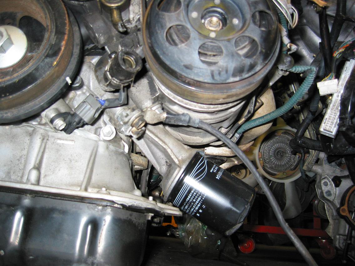

On the V8 the oil filter and cooler are on an arm about 10cm long which protrudes out and down, like this:
[Image: 1uzfevvti_ac3.JPG]
That pic is a front sump setup, with the mid sump the steering rack sits there.
People come up with loads of weird and wonderful solutions for it, like tapping the oil pump (!!!), cutting the arm and welding a boss on the end of it etc. I think that plate is the best and easiest way though. I can then combine it with a shiny relocation kit by just binning the sandwich plate off and get an oil radiator in there as well. The RX7 had 2 stock oil coolers fitted behind the bumper as stock, so I shall copy that setup! Means the oil lines will all be pretty short!
