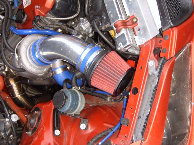

06-02-2018, 02:39 PM
my engine bay
[Image: SUC50206.jpg]
[Image: SUC50210.jpg]
[Image: SUC50208.jpg]

7,101
06-02-2018, 02:40 PM
Where's the fish?
06-02-2018, 02:40 PM #18
Where's the fish?
86
06-02-2018, 02:45 PM
thats an idea a 4x4 is200.:laugh:i think they do one.
no bonnet catches are the next thing to pull my carbon bonnet down.get rid of the 1in gap.
