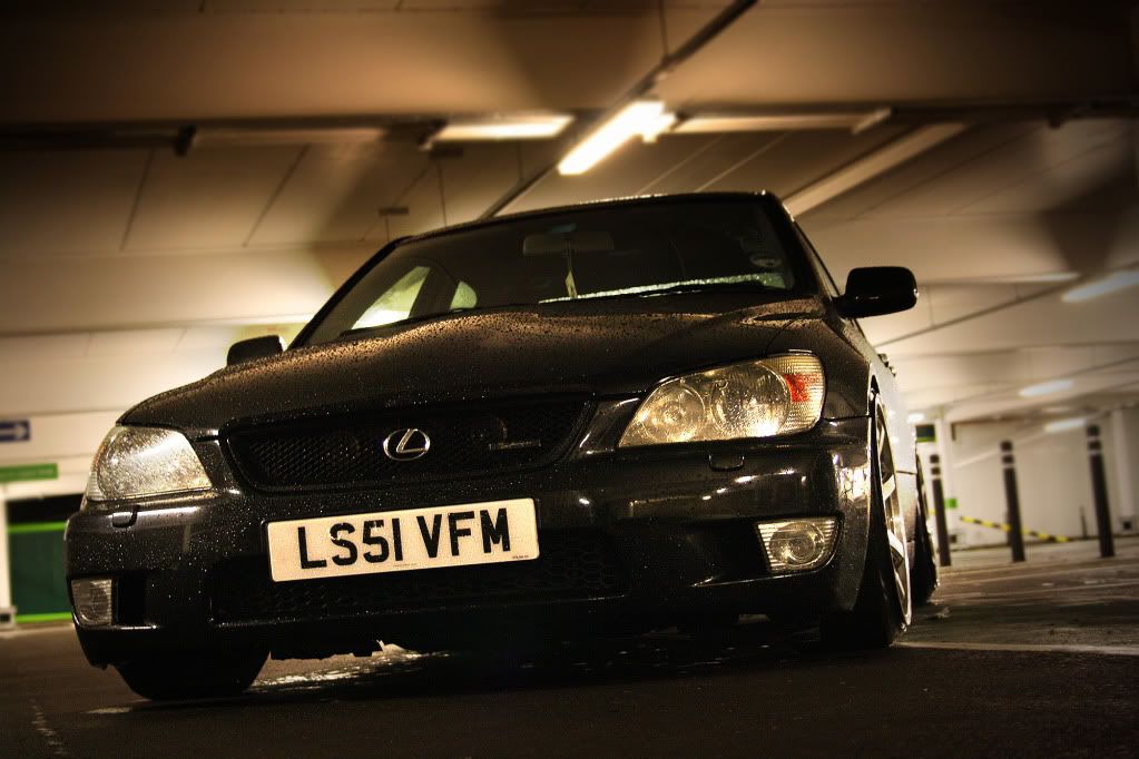

29-10-2018, 04:18 PM
[Image: FrontDiagonalLighter.jpg]
not to good of a picture but that was when it was a tad higer on the front and old bumperrrr...
Steveboiboi

3,006
29-10-2018, 04:37 PM
all is200's have camber adjusters standard......

7,993
30-10-2018, 07:55 AM
But you can get aftermarket camber adjusters to help give you further adjustment, e.g. if with lowering you can't get back into the proper range.
