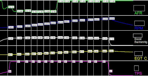

Sorry boys, the IS does not have 240bhp. at the dyno the belt slipped at 4500rpm, so I had to 5500rpm only 0.38 bar. and therefore he has only 209bhp at 5500rpm.
EDIT:
here some results
[Image: kw%20diagram%20lauf2.jpg]
and here the zeitronix log
[Image: druck%20diagram%20lauf%202.jpg]
you see, if the belt did not slipped, it had more power at 6300rpm maybe
EDIT:
here some results
Thats dangerously lean mate from 4k onwards! what ecu controls your injectors and bigger pulley?

Just the HKS FCD!
