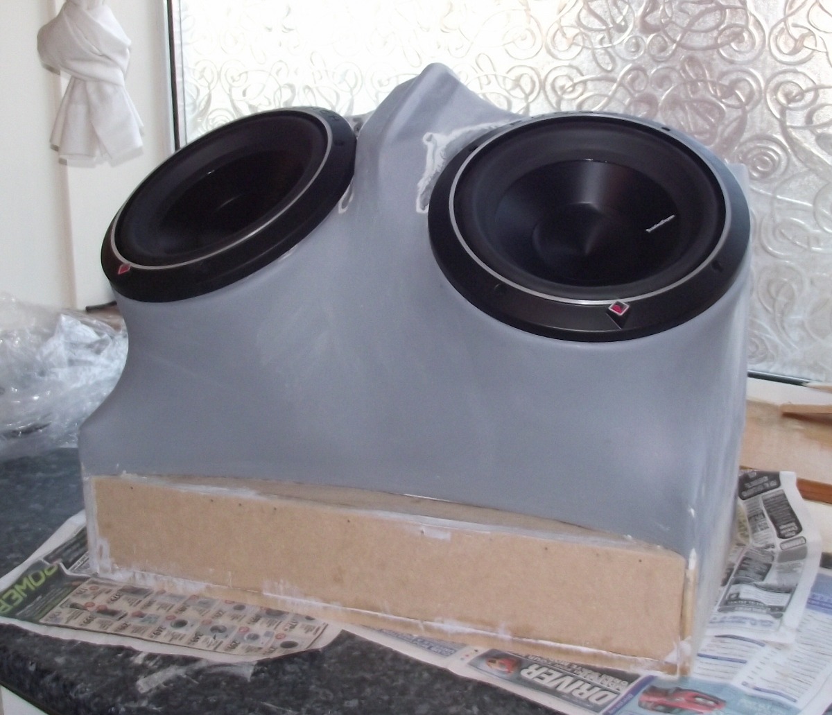

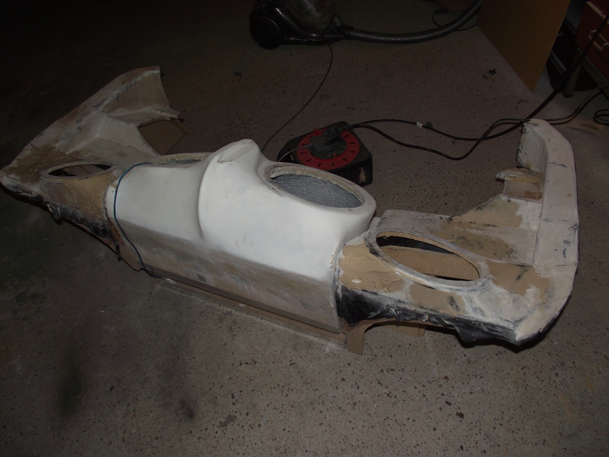

I said I needed to re-jig the bog volume because of going for MUCH more powerful speakers...... 21 Litres ON THE DOT... Woohooo! (per sub of course) Got the odd teeny void spot in there so I reckon all in all it's bang on the recommendation from Rockford Fosgate on a fully sealed enclosure
Yeh yeh yeh... bit more sanding yet lol. I have it all reinforced with extra fibreglass, odd spots and pockets smoothed out, and wadded/padded inside now.

they look gooood Confusedmoke:

Ooooh this looks good

Cheers guys.
Those pics were yesterday... today, been sanding like crazy, right down to the 1200 grit to make sure I got everything. Of course, it's white primer now because will be yellow - going through tons of paint because white doesnt cover that well. May go for another test fit tomorrow and put another pic up.
If I thought this was a lot of sanding, am dreading the other parts!

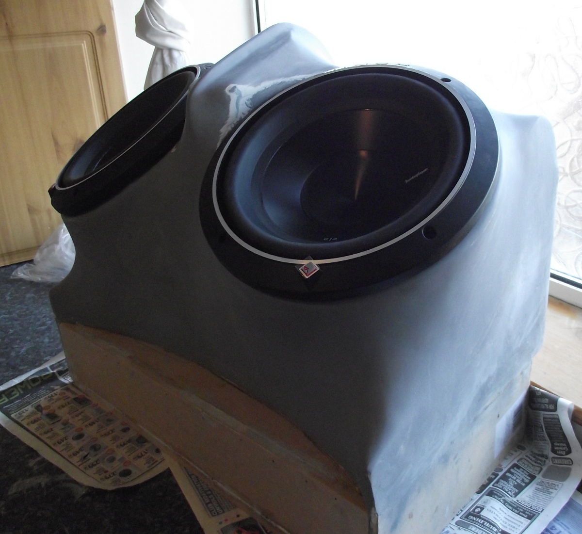

Latest update from Rose, she's out in the garage working on it now, so asked me to post it up for her.
I said it would be better today...
[Image: gettingreal1.jpg]
[Image: gettingreal2.jpg]
still working on it tonight.... laters! Smile
