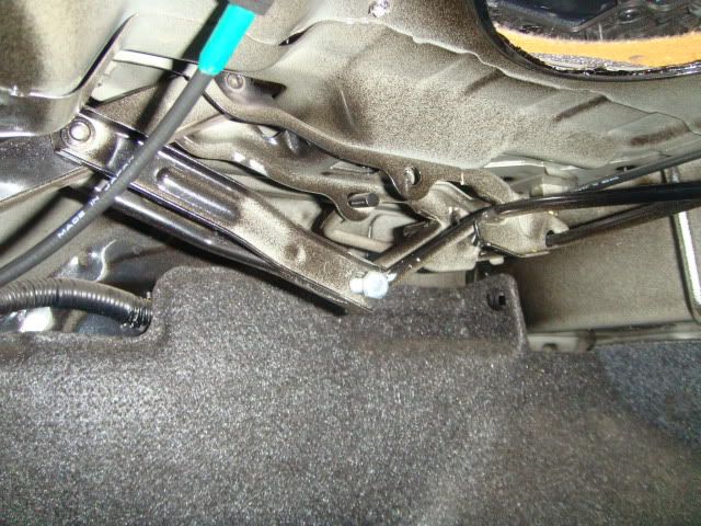

I made some pics today.
Before trunk did not open at all. just 1cm pop and thats it
I have 5mm screws in both sides and now trunk pops up like P.Lindblom's
[Image: DSC08886.jpg]
[Image: DSC08885.jpg]
[Image: DSC08884.jpg]
