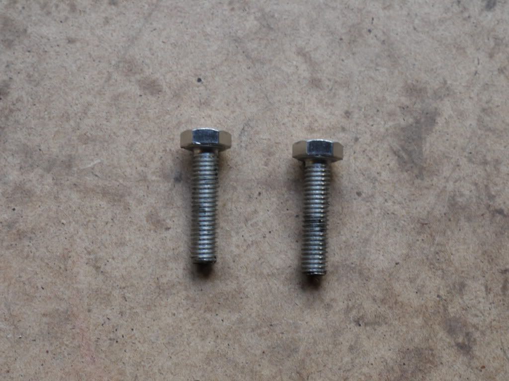

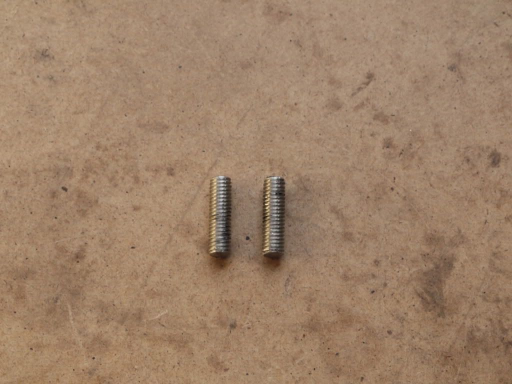

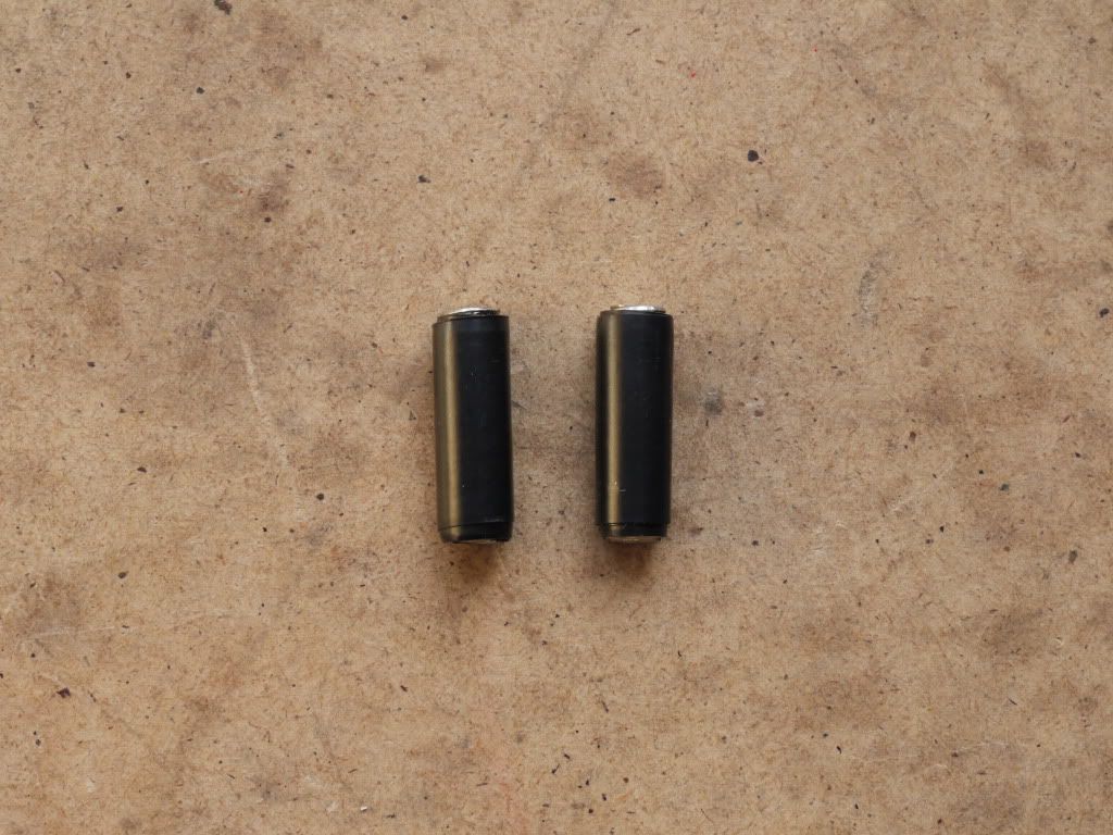

Well I did this simple mod on my boot lid today.
I used 2 5mm S/S hex head screws. I cut the heads off and as I didn't fancy the metal to metal contact decided to wrap them in insulating tape........

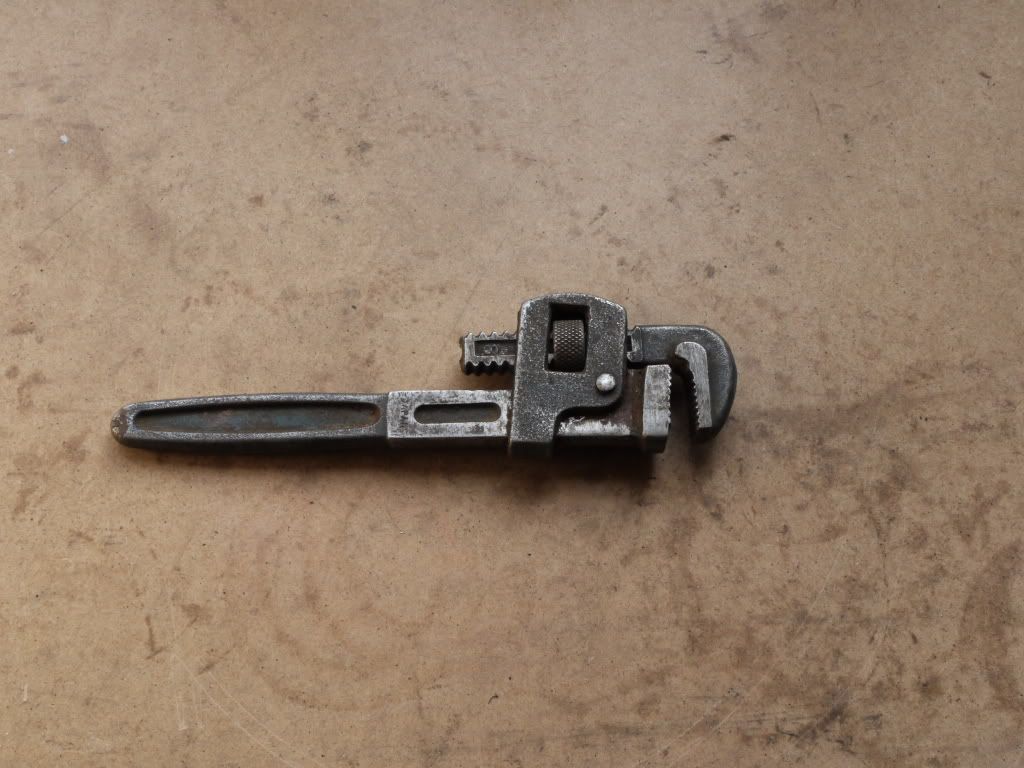

I used a small pair of stilsons to prise the springs out.....

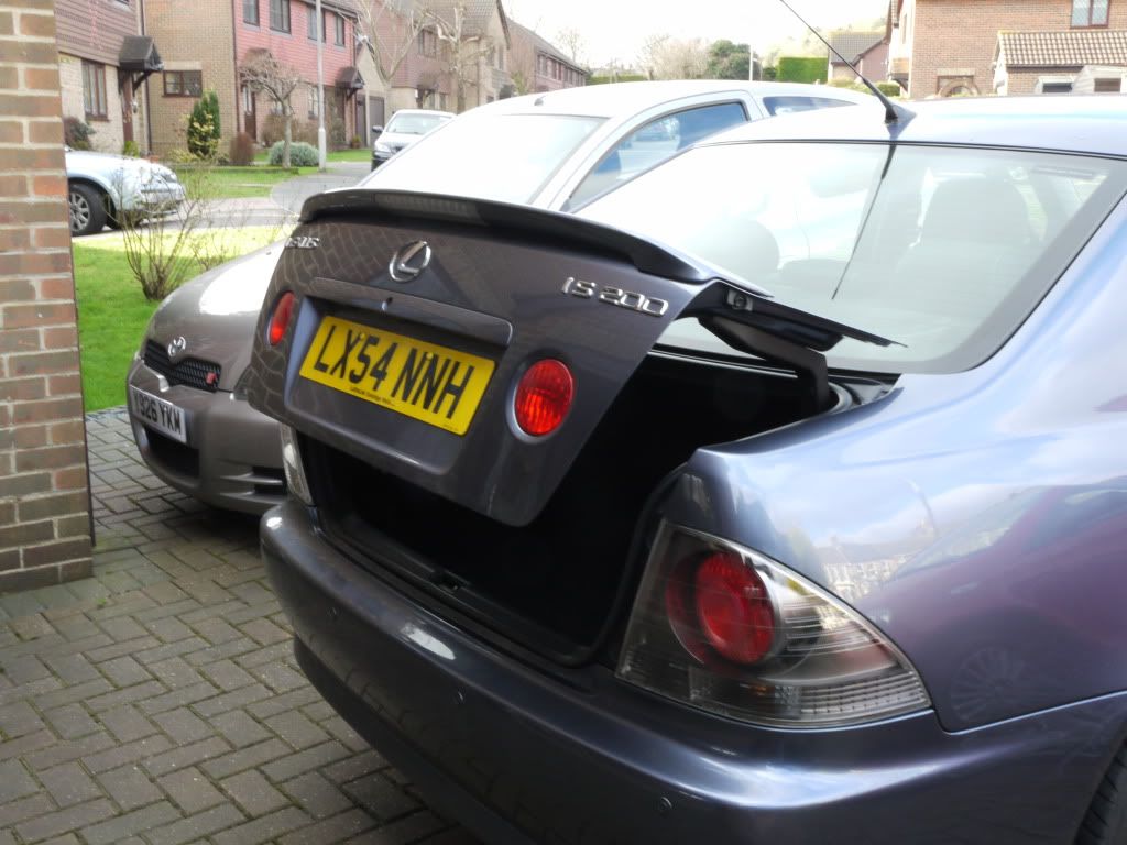

and it now pops up about half way....
[Image: P1000595.jpg]
I could put bigger screws in to make it open all the way but I'm happy with this. Plus I think if I used bigger screws there's a chance that the spring could come out of the slot.
