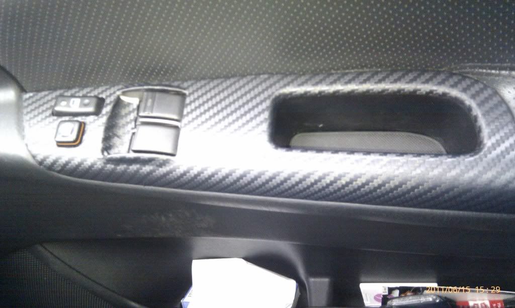

[Image: IMAG0769.jpg]
[Image: IMAG0768.jpg]
Right the Carbon wrapping of the interior is done!!
Just got these to install now..
[Image: IMAG0770.jpg]
newdriftking
05-05-2019, 09:43 AM #66

how easy is it to carbon wrap stuff? i want to do mine now! and where do you buy the wrap from, and what tools do you use!?!?!?!

Carpediem how easy is it to carbon wrap stuff? i want to do mine now! and where do you buy the wrap from, and what tools do you use!?!?!?!
Its VERY easy to wrap stuff, I bought mine from ebay 3m Di-noc CA-421 is the black..
The only tool you need is a hairdryer to soften the wrap, paitience and a craft knife to cut the wrap.
It is quite simple to do, I couldn't believe how easy I found it. The 2 door handles only took 10 minutes each...

what do you do, just lay it on and cut round the buttons etc?

lay it on, use the hairdryer to soften it so it forms to any curves etc..
Then were the buttons go, I normally cut the shape of the hole but about 5mm away from the the edge of the hole, so that when you heat the wrap you can push it into the hole and it pushes down, to look like it's supposed to be there...
I'll get some close up pictures of the door grab handle to show you...
