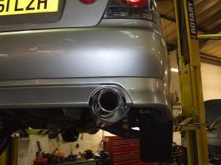

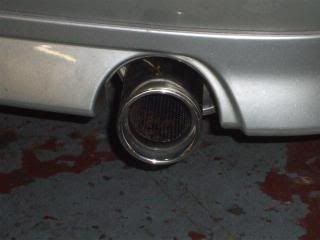

23-10-2017, 10:00 AM
#80

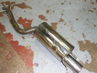

Scooby Prodrive backbox
[Image: LEXUSTTONGUES025Small.jpg]
Rear View new exhaust in place
[Image: LEXUSTTONGUES031Small.jpg]

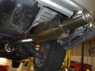

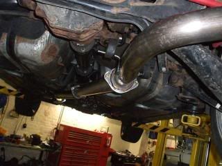

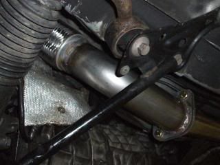

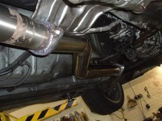

[Image: LEXUSTTONGUES026Small.jpg]
Underneath - neat fit I think.
[Image: LEXUSTTONGUES027Small.jpg]
[Image: LEXUSTTONGUES028Small.jpg]
[Image: LEXUSTTONGUES029Small.jpg]
[Image: LEXUSTTONGUES030Small.jpg]

23-10-2017, 10:00 AM #80
