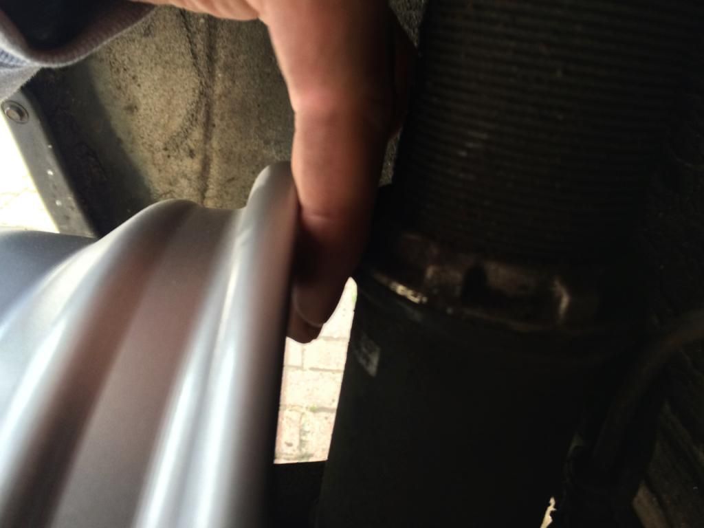

I also changed the discs and pads on the rear. Unfortunately the thicker pads meant that my sticking calliper was a lot more noticeable. Sad
[Image: IMG_6929_zps1bc88bb6.jpg]
So i ended up taking both rear callipers off and sending them to these guys http://www.brake-caliper-painting.com/ to be refurbished. I realised my mistake almost immediately. I had forgotten that i was driving to Silverstone the next week for the British Grand Prix. After a frantic phone call i was assured they'd be finished and back to me in time. Four days later I had heard nothing, another phonecall, "Oh we need to order new pistons, you'll have to pay extra." I was quoted for a full refurbishment including all seals and pistons, turns out that wasn't the case apparently. So begrudgingly i paid up still hoping to have my callipers back in time, they said they'd call me the next day when the pistons came in and they finished the rebuild. Waited a day, guess what no phone call. I call them, get some excuse, the pistons had arrived but they hadn't done anything. Turns out i wasn't getting them back in time for the Grand Prix.

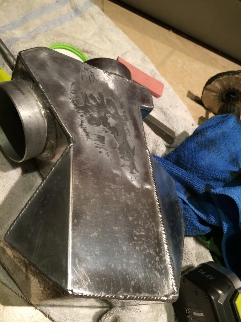

So a little update. I got my hands on an ARC Intake Chamber, it was in need of a tidy up.
[Image: 7BA41F7C-D48E-42A7-BD31-CB31BADF72BE_zps6xa3ayc6.jpg]
So I gave it a bit of a polish.
[Image: 64FC2DAE-0369-4190-9892-E31E61C7473C_zpsv89wiyxo.jpg]

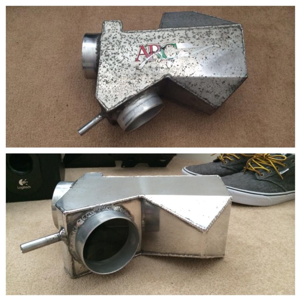

New decal is on the way. A before and after shot.
[Image: 7EE66EF1-2188-41F9-A7C6-94332B607C7E_zpsb17bdafz.jpg]

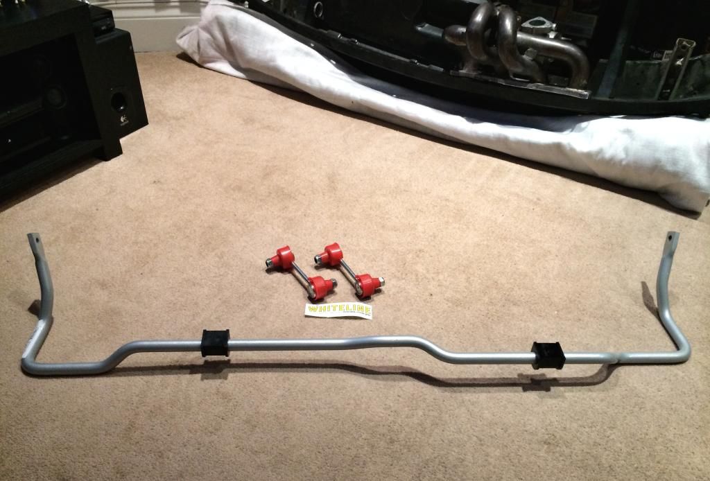

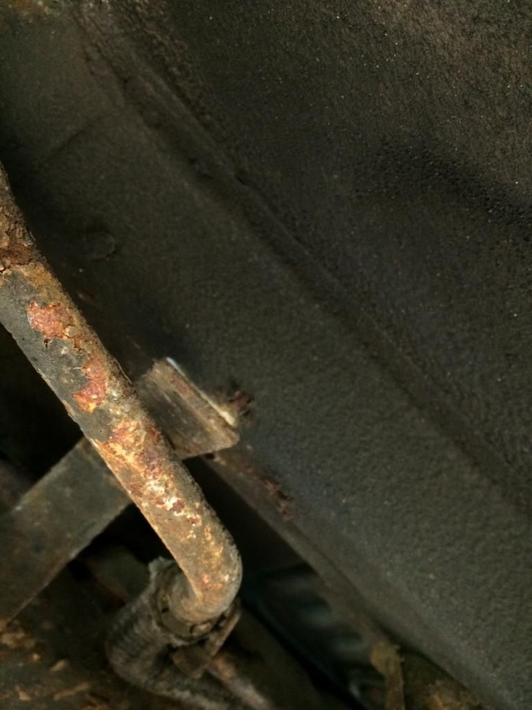

Quick update. After being driven mad by a knock coming from the rear of the car i finally bit the bullet and bought a new rear sway bar. Ended up getting a Whiteline one along with some new droplinks also Whiteline.
[Image: F51927E7-1FFE-4BFA-9C96-BC0DF7840523_zpsefnb6iyl.jpg]
[Image: E49E9579-46E0-4875-9DDD-96C7646F2637_zpsloylcpwb.jpg]
Fitting it was easy enough even though it took a bit longer than expected.

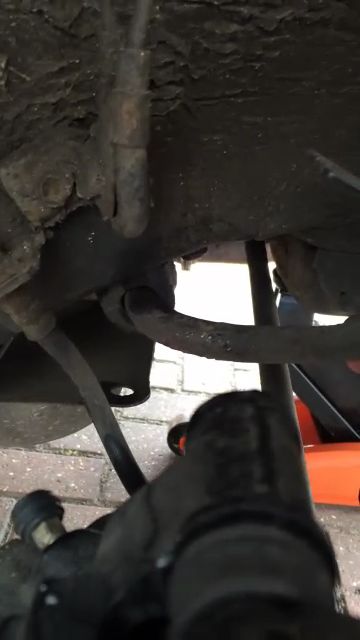

Removed the old droplinks.
[Image: 570B22D6-B657-4823-8EC0-6662EF3DA9F2_zpskowirule.jpg]
Undid the bushes and brackets.
[Image: 38F35379-3295-4FEA-9479-078A451969B7_zpsadbuelxd.jpg]

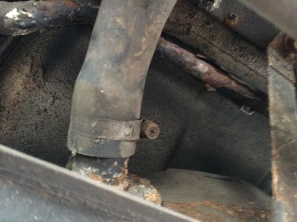

Loosened off and removed the fuel filler hose.
[Image: 37234626-C8C0-417D-BE58-C44B5F6E5D7E_zpsqcmqjqnv.jpg]
[Image: A636EE50-A458-403F-A45F-0B44960A6C46_zpsfbgzexiz.jpg]
Same with the breather line. Then i had to loosen off the fuel tank straps.
[Image: F0B201BB-677C-4F5E-89B9-6C2CF0A0B9DB_zpsmdntjfdi.jpg]

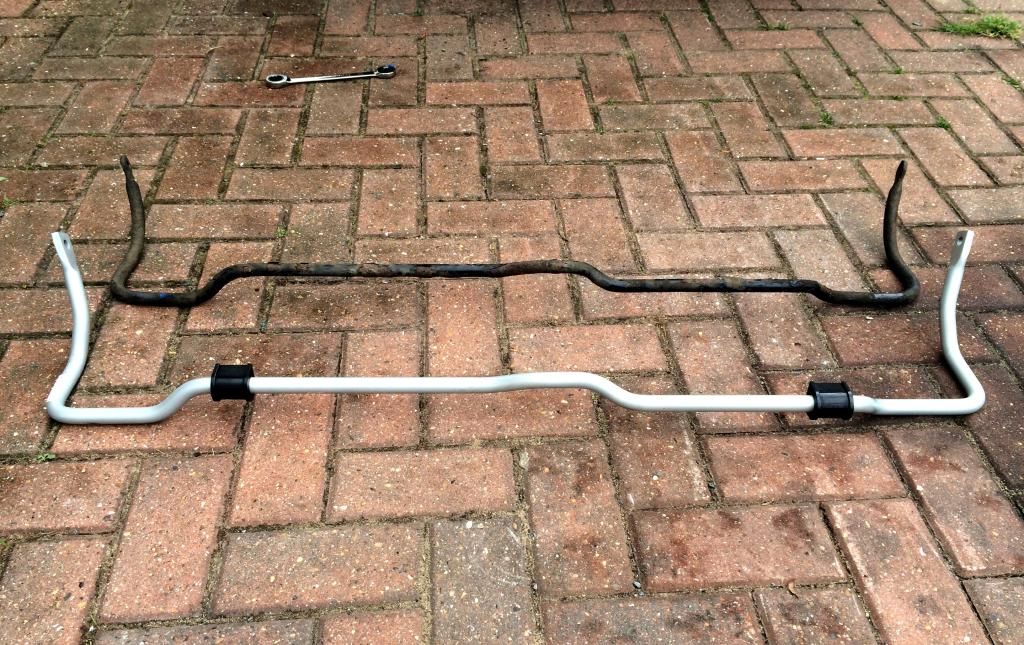

Then it was just a case of dropping out the old sway bar with a bit of wiggling.
I wonder where that knocking was coming from? >.<
[Image: th_9C6473B9-79F0-44BA-AF7E-E94E00FCB4BB_zpsfcw665cw.mp4]
Anyway out with the old and in with the new.
[Image: 47E77CB6-8B18-47E3-AF5B-F308F102FA0A_zpsqp4uubpm.jpg]
[Image: AA6AE8E2-BC0D-457F-8B1B-16BD5A7AB3AB_zpsviuxhugd.jpg]
All fitted with the new droplinks.
[Image: 1A758E9E-F97C-485B-952E-806441F0C25F_zpss2t5stsb.jpg]
[Image: 04E7CFCD-17CF-41FE-BEF8-4CF92BD8F8FF_zpsqozvpnu1.jpg]
[Image: DA037EAD-FBF8-414A-B02F-9FA9131745B8_zpsx2tt8iac.jpg]
Unfortunately i managed to ****** one of the fuel tank strap bolts in the process, luckily a new bolt was only £1.60 from Toyota.
[Image: E94DD697-1541-4215-A375-548428DADF93_zpso7nq6yyf.jpg]
The new sway bar has made a huge difference to the handling of the car, its a lot more planted in corners now. I guess that shouldn't be a surprise considering how shagged the old one was. Oh and no more knocking!
