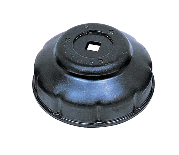

i have done the filter change on the is200 quite a bit and the best tool is the cap type
[Image: sykes-pickavant-notch-cap-oil-filter-wrenches-9.jpg]
forget about straps, chains or the type with 3 legs etc they are a pain in the ass on the is200 as access is ****.
pop cap on, undo, job finished, no adjusting or fiddling around

17-07-2020, 10:36 AM
That l
Sounds good rob, any idea where I can get one from? :-)

17-07-2020, 12:10 PM
They look pretty good
I use a chain and with the access on the is200 is a nightmare at times, think I may invest in one of these

18-07-2020, 11:07 AM
i got mine from an auto factors.. there are different types so make sure you order the right one....
count the sides or flutes on the filter and have a look on ebay
