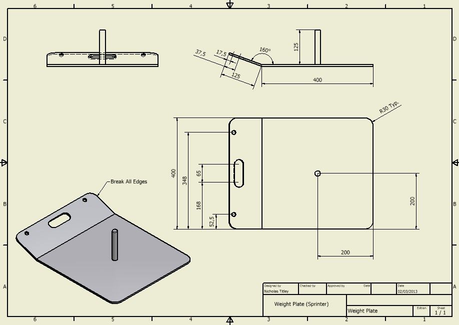

Drawing is missing some detail is this correct?

If no one else gives you a price text me 07970923314 I will get you one.

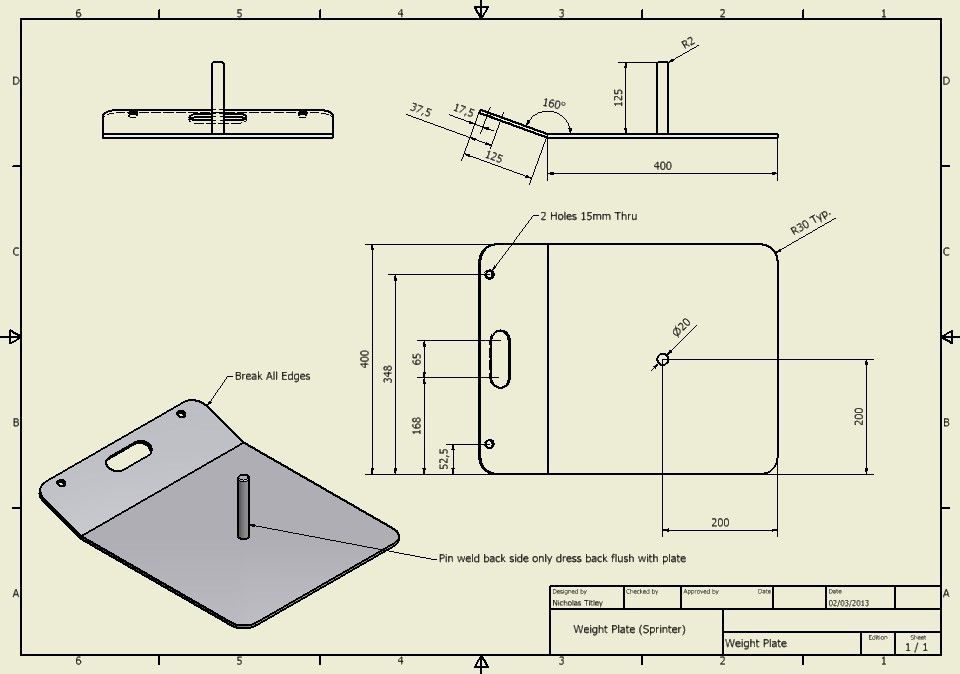

OK try again even I missed some details

Nick T
19-01-2021, 05:58 AM #4
[Image: WeightPlateSprinter_zps99da7436.jpg]

Nick T If no one else gives you a price text me 07970923314 I will get you one.
[Image: WeightPlateSprinter_zps7bcab418.jpg]
Thanks very much for that, I'll be sure to give you a shout if I can't find any suitable material at work Smile

19-01-2021, 03:19 PM
I can do thinner as well so what ever you end up with!
The only issue if you go to thin is the 20mm pin security although the weigyhts should help support it!
