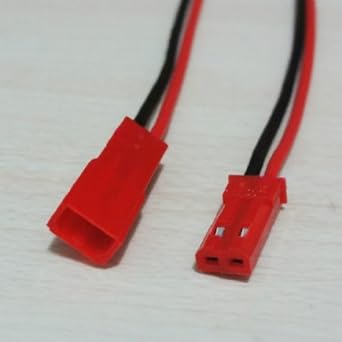

Next, ordered up some of these JST connectors
[Image: 41%2B2yN2owyL._SX342_.jpg]
These are so I can cut the USB cable in half, feed it inside the hole in the side of the housing, and connect one of these to the end of the USB cable (outside the housing) and the other to the other end of the USB power cable, so it's easy to unplug if I need to remove the housing from the car. Even though I'm using the supplied 12v adapter in a cig plug, I wanted that mounted down and out the way, so it wouldn't be accessible without removing the heading, so this seemed like a good idea.
