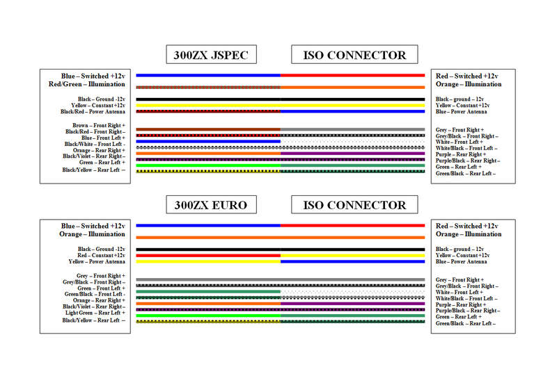

Here is the wiring colours for both the UK and Jap 300ZX.
I found it very useful. If you dont like chopping wires/dont need to tidy up the wiring too mush to make room for other installations, I found the standard Nissan ISO connector in Halfrauds to fit onto the jap perfectly.

Rep added for good info:thumbup1:

As above... Good info!

Good bit of info!
ive added some tags as well.
