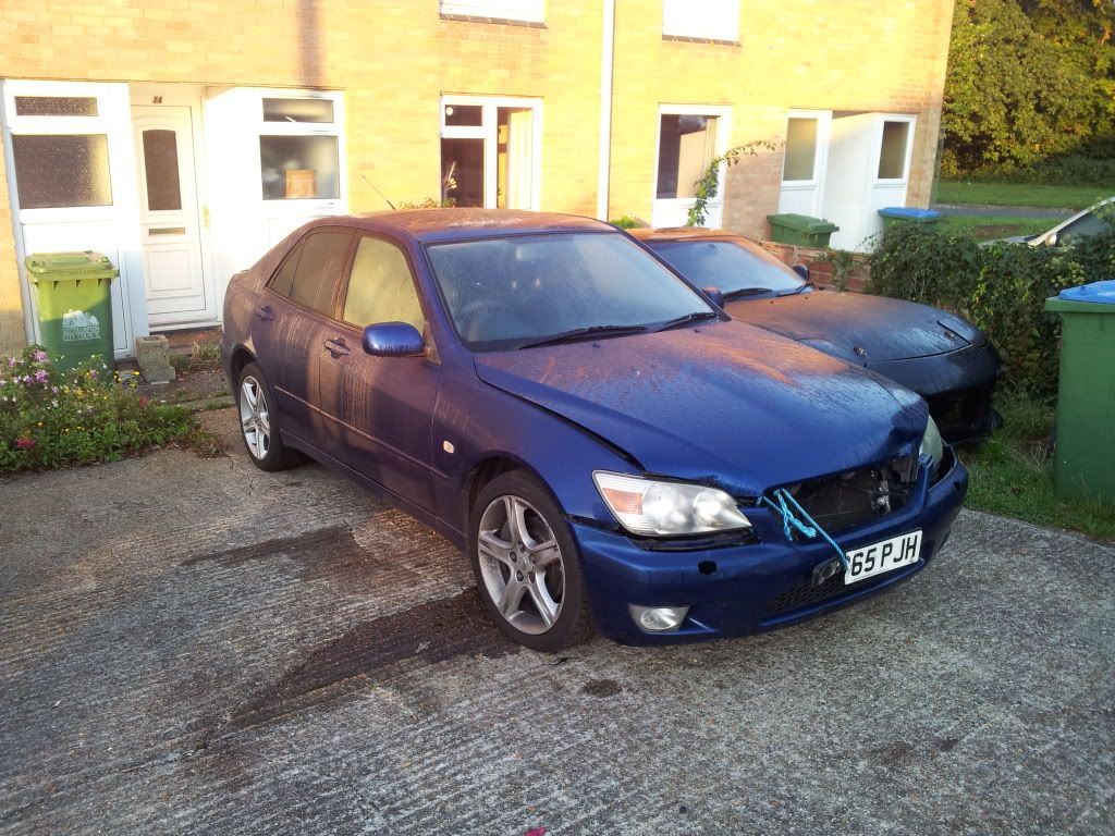

Well as you all asked so nicely I thought I better start a project thread for my Lexus V8 venture, I started by looking for an ideal donor car, I want to use it over the winter whilst I rebuild the engine and sort out things like the prop shaft, manifolds etc. I came across a car on Ebay that had encountered the rear end of a car with a tow bar and picked it up for a bargain price, it has full service history all from Lexus, cambelt has been done, nearly new Dunlop tires etc etc. So here is a pic on arrival at my house
[Image: 2011-10-01074756.jpg]
I then went trawling through ebay and found most of the parts I ned, so she now stands like this
[Image: 2011-10-16142652.jpg]
I am just waiting on a new radiator as the second hand one I got has a nice hole in it, I also need to a different bumper as the other side of it is not very healthy which should all turn up this week.

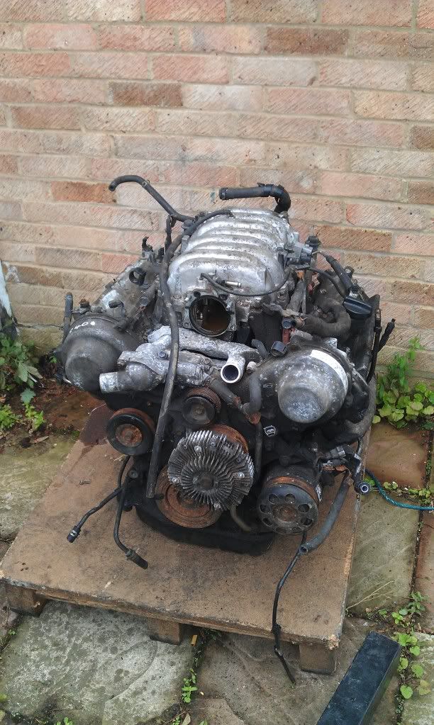

Now onto the fun bit, this is what I have waiting to go into the car in the new year
[Image: IMAG0264.jpg]

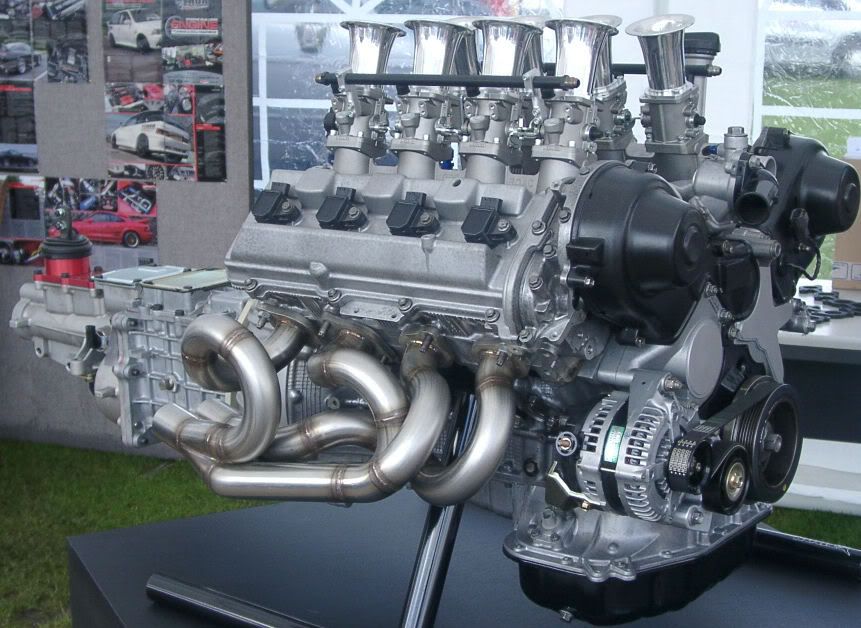

And what I want it to look like before i chuck it in the car
[Image: THOR_UZ_Race_Engine2.jpg]
(picture courtesy of Thor Racing)

going to be a interesting project finally someone using the proper 1UZ Wink, just noticed if you are going to be running ITB's and a charger how are you planning on doing this enclosing them in a custom case?

Dan_Turism0 going to be a interesting project finally someone using the proper 1UZ Wink, just noticed if you are going to be running ITB's and a charger how are you planning on doing this enclosing them in a custom case?
I am looking to run itb's to start with the put on shorter runners and enclose them, i have found a couple of useful sites with most of the info i need on them to make things a lot easier. The intake design consists of a dual kidney style intake a bit like the f40 in design that will close off the trumpets, I'll try and find a link to pics.
In regards to the box all that is needed is the auto bell housing an adapter plate made up which i already have the cnc plans for then use a Toyota mr2 clutch and flywheel and away i go :-)
