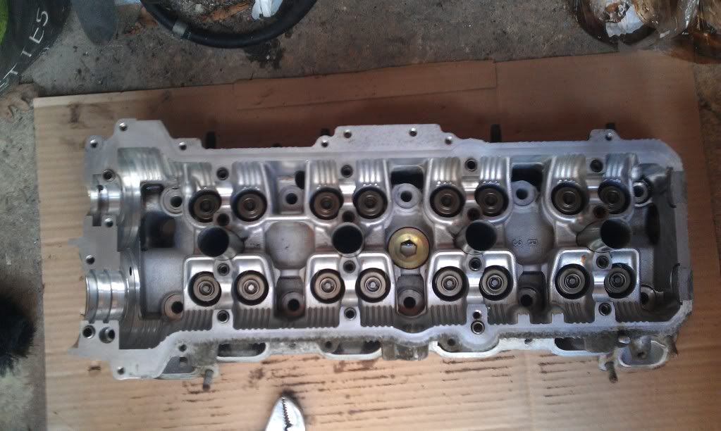

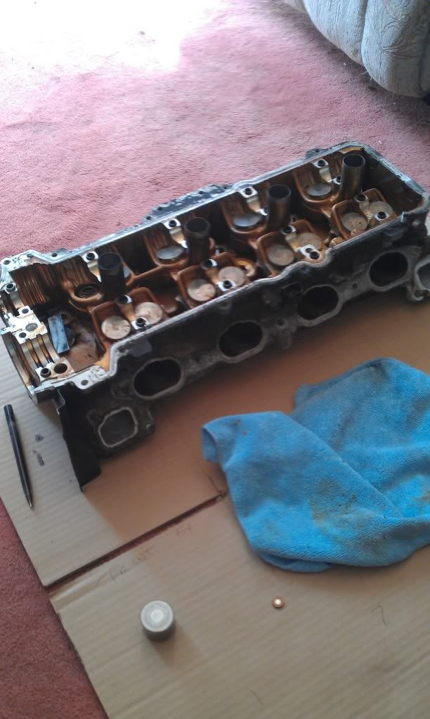

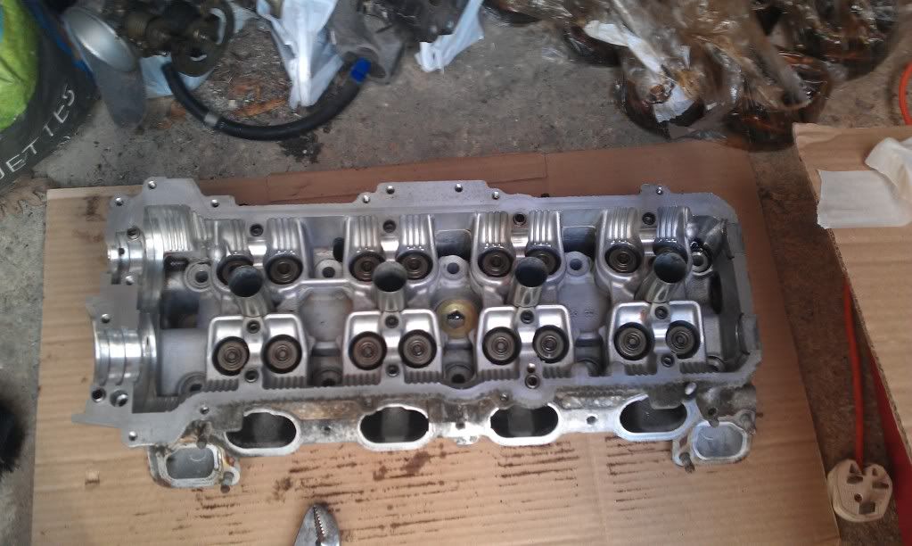

Here are some pics of the tear down of the engine so far and some cleaning
Head pre clean
[Image: IMAG0295.jpg]
Head post clean
[Image: IMAG0296.jpg]
[Image: IMAG0297.jpg]

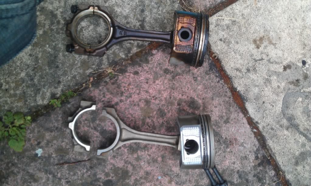

Piston pre and post cleaning
[Image: IMAG0298.jpg]
Head pre clean
Head post clean
