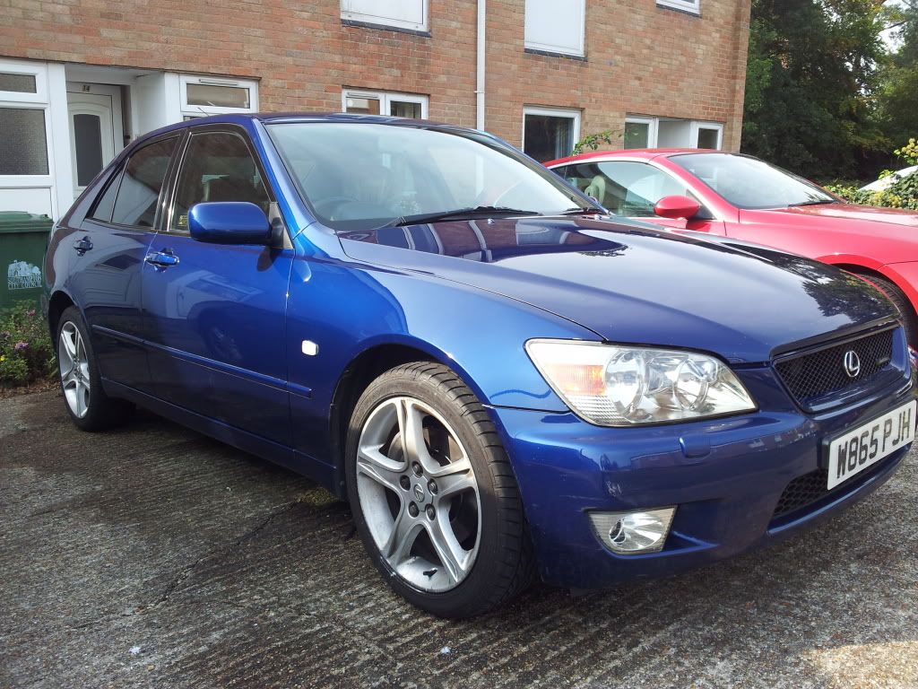

Just had my mate come over and do a quick mop of the paintwork, he is going to do it again next week once the new front bumper is on but here is a quick pic. He also mopped the headlights for me so they are now very clean :-)
[Image: 20111023_122744.jpg]
